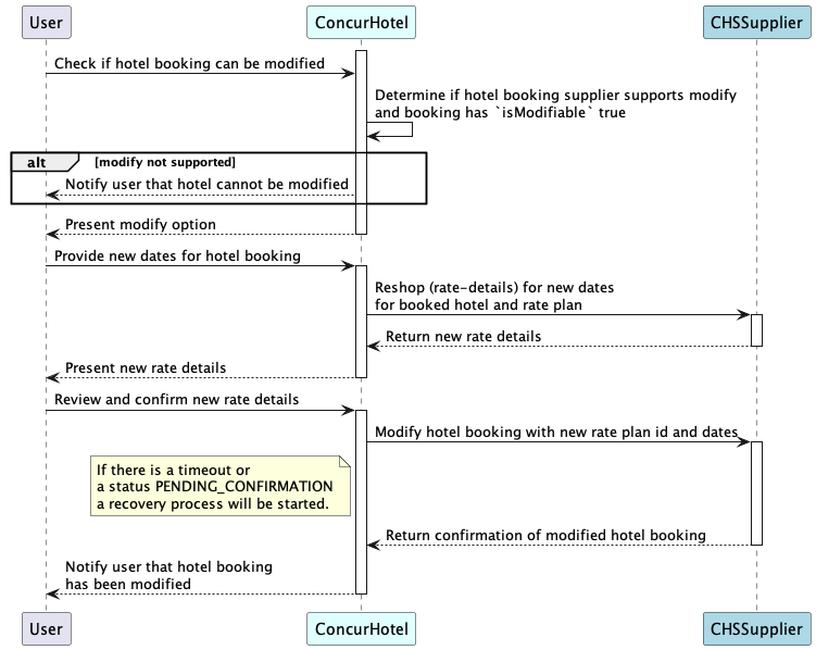

This document describes the workflow that will be used if a CHS supplier wants to implement support for modifying hotel booking. As of now, SAP Concur supports only modification of dates with possibility of changing other attributes in the future. The supplier can choose to support this feature by implementing the Hotel Service v4 modify endpoint.
Workflow
At a high-level, the workflow consists of:
- If
modify
is supported by CHS supplier and booking is marked asmodifiable
, user is provided with option to change dates for hotel booking and user updates the dates (checkin/checkout/both). - SAP Concur invokes
rate-details
(used asreshop
request) using sameratePlanId
as used in original booking along withconfirmationCodes
that provides all confirmation codes and pin associated with booking. - CHS supplier provides price details for the new dates based on confirmation codes and/or original
ratePlanId
. Hotel room/product is expected to be the same as original booking. Note thatratePlanId
in response can be different from original booking. - SAP Concur UI presents change in cost and new pricing to user for review.
- User accepts and confirms the change request.
- SAP Concur invokes modify endpoint with new dates and
ratePlanId
from previous response along with confirmation codes and pin. - CHS supplier updates the booking with new dates and returns the updated booking details.
Below is the sequence diagram for the flow:
